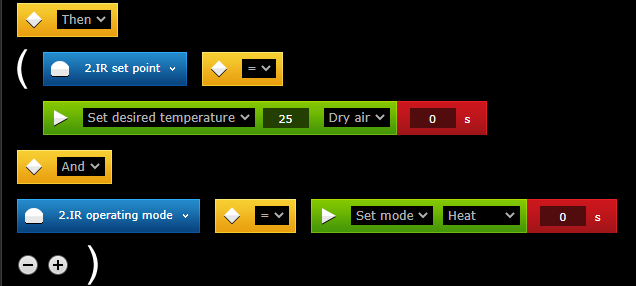

I have the same problem with the ZXT-120. No matter what I did (reconfigured deleted+added) it didn't change.
However, it works properly, it just doesn't show up.
In the scenes, if I set it to cooling or heating, the controlled device (air conditioner) works properly for now.
