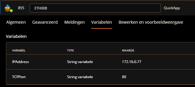

Looking for help to convert HC2 VD into HC3 QA
Good afternoon,
I would like to convert an HC2 VD to an HC3 QA but am running into some communication problems with regard to net.http
The code is not complete yet, but now I get an error in the http request.
-- Mijn Code

-- Code for 1 relais --
function QuickApp:btnUpdate()
    HTTP = net.Fhttp(self.ipaddr, self.tcpport)
    HTTP:setBasicAuthentication("Uname", "Passwd")
    function getXML(data,name)
    return data:match("<"..name..">(.-)</"..name..">")
    response, status, result = HTTP:GET("/status.xml")
    fibaro:debug("Result = "..result)

/monthly_2022_11/image.png.1d4e2ae76a6a28e0a0bb7926b37cf0bd.png" />image.png.5719c4f20517ad3293e4167b7d13e3ab.png
orginele file zie onderstaande link
