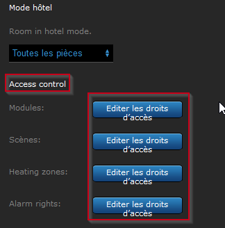

    For those who add the same issue event in 2022/2023 and found no "solution" as only one account is used.
    When room or modules are not visible in Yubii, juste go in Web UI on your Fibaro box:
    Configuration (settings)=> Access control => User (not super user and even if your User is the same as Super user) => Edit
    /monthly_2023_02/image.png.540de6ebd4a8915fd1c37cb6fd100cbc.png" />
    Check that all what you want is check because each time you add something or you reset something, it is not automatically added and your "super user" is "just a user" in this section.
    Seems logical but long time ago I did not have to do that in previous version (HC2) This made me confusing.
    Regards.
