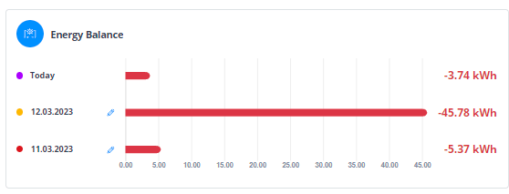

    I'm new to FHC3, coming from a home-grown OpenZWave system. I have a single-clamp EU HEM5 fw1.37, which worked fine for years, sending readings to my hub every 60s. Now in HC3 (5.140) I can get the HEM to pair, configure etc. and I see the occassional reading appear in HC3's history, but what strikes me as odd is that I only get (or receive from HEM?) updates every 4 hours. I never had this connected in a previous HC3 version, so I have nothing to compare to.
    You can also see that each device receives two updates, with a zero value and positive value. I think this is screwing with the calculations for total, because apparently yesterday I used 45kWh, but I don't remember leaving the oven on :) The real value is more like 14. I have a fealing that HC is summing the differences between oldValue and newValue for each reading, and the zero readings are resetting the count.
    I've configured the HEM to report frequently, following the settings in other threads on this forum, but HC does not receive or register updates other than every 4 hours. The HC UI assumes this is the three phase model - obviously therefore some settings values will be refused by the HEM, but I think I've followed the gist.

    @TimP My parameters seems ok with single phase :
    Add singlechannel if missing :
    And parameter 2 to 1 :
    But in energy panel it's wrong for the moment (I don't use it because not enough possible configuration).
