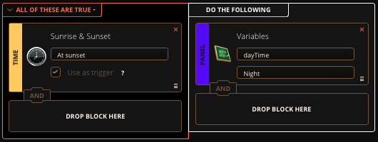

I Do notice you have a global-variable for day or night time. Is this also running in another scene ?
Would be nice to have that too :)
Got it:
Edited by GeeMoney
Those are two simple block-scenes, like this:
/monthly_2023_03/image.png.854a441e359f6961ec9c6cf62c92d72b.png" />
