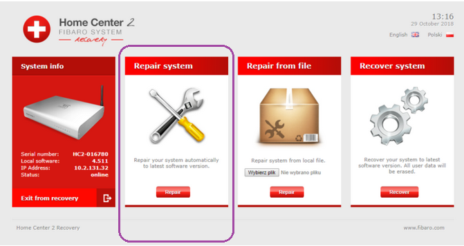

@GGFLThe steps for hc2 recovery, are described
    @Fabir Thank YOU!
    I ended up using the repair system option and I'm back online :-)
    Backing up my HC2 know.
