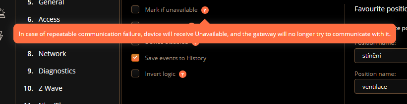

1) I have experimented with different polling interval (30 to 120s), but it doesn't seem to be any difference.
/monthly_2023_12/image.png.620d359d66ee2321cc43c500ffca053d.png" />
2) Disabling "mark if unavailable" fixes it only for a short while
