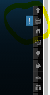

    The weird thing is when i deselect the first option "select when drive is far away from Home Center" i get an exclamation mark next to the Save Settings button on the right but the save button is disabled...
