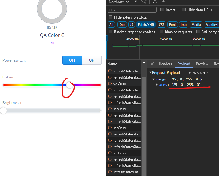

I think there is bug in setting of colors via Colour slider (red part of image).
In case of change it generates only 2 parts from RGB - Blue part is always 0
Or did you change it to i.e. XY color scheme?
Edited by petrkl12
I checked quickly and args for the action are being sent correctly, examples:
/monthly_2024_01/image.png.3b66335bd8ab2219158081341f6e7dfa.png" />
Could you check in your system in bowser dev-tools?
btw., there is no 5th arg in this action for brightness by default so webUI does not ever send it.

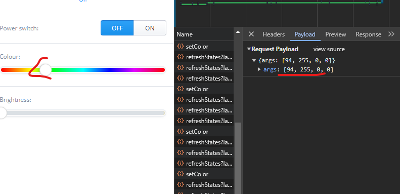

    hmm, this from my Chrome - latest version
    in Edge

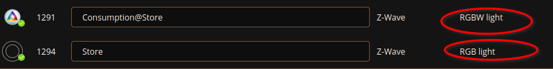

    I have a similar issue with about 16 of 32 RGBW2 controllers
    They appear in 2 categories.🙄
    /monthly_2024_01/image.png.62fad9027784f2418c31456792dd1d6c.png" />
    At first it didn´t seem to be an issue, because all the controls are available in the WebUI, (HOW?? 🤔?)
    but in "Block Scenes", one can not set the missing channel - in my case the "White"
    I tried numerous ex-, and  inclusions, re-configurations etc. nothing fixed the issue
    I have reported this about 8 month ago to the support - but so far - "All Quiet on the Western Front"
    Maybe this related to the above issue?

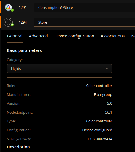

    Just change the role of the device on configuration endpoint to RGBW and it will just work ok :)
    @m.roszak
    do you really think that this best example how to setup colors? :)
    and of couse I can give your programers to access to myHC3 to test it where is bug ...
    If it where that easy....
    As you can see.
    As you can see, the ROLE is ¨RGBW" AND "RGB"
    THIS is the same device
    I can select the role for the "Consumption¨ device
    BUT
    Not for the "Light" itself!!
    the only option there is "LIGHTS¨
    The ROLE is Missing!!!!
    and as I mentioned before:
    I tried numerous ex-, and  inclusions, re-configurations etc. nothing fixed the issue!
    Tonight ( 8month later) I went through all of the "RGB" devices again (16!!)
    ... and did a "Soft recon"
    Guess what:
    All of the RGB are now "RGBW"
    So something has changed somewhere during the last few firmware upgrades  :-)
    .. and YES,  I do READ the release Notes!!!
    ...thanks for the info!
