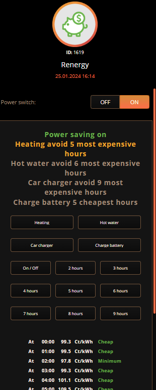

I have always used the climate panel and in a combination of Renergy QA's too manualy overwrite the schedule for 1 hour to set a lower temperature if my house are close too using the Effect Limit we got in Norway.
(we have Limits on 2,5,10,15,20kwh for each hour and if we only use 10kwh normaly and have 3 hour during a month on 20kwh we have too pay for 20kwh).
I also control the same way based on the Spot Price. if the next hour is expensive, it will lower my termostat about 3-4 degrees (where temp is set in the blockscene).
But this is set up with block scenes, virtual binary switches to toggle on/off the automations. and it isnt so self explaining how to use it 😅

Since I got the Renergy QA's I also made it listen too the Renergy events and display the last time the events triggered the Thermostat.
and it is possible to easy turn the events on or off.
