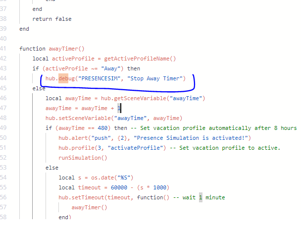

Actually, I checked the code for Presence Sim and tags are defined there, look:
17 minutes ago, m.roszak said:
Don't worry :)
Yes, the tag are there and I must have made a mistake when I activate first the scene.
