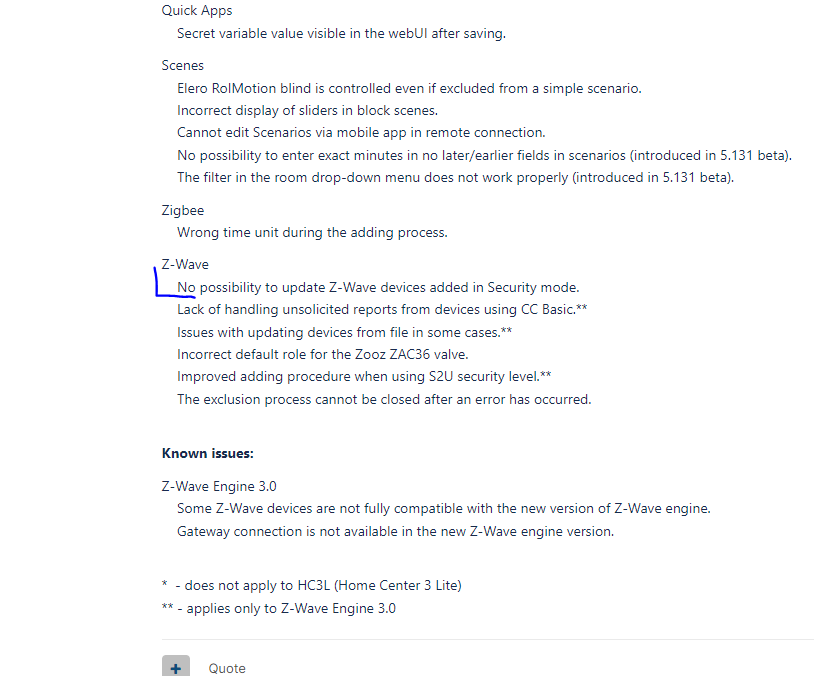

    I missed that one. I will give it a try in firmware 5.150.
    /monthly_2024_02/image.png.a479ebf0d845357c30d33943c66048a3.png" />

    4 hours ago, m.roszak said:
    I will check in which exact version of the hub firmware.
    5.140 GA :)
