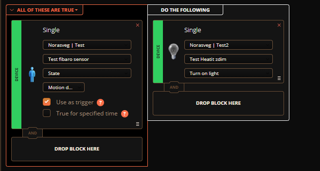

Motion detected here :D

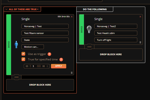

motion canceled for 3 min here :D

    I need to look at this, I do have 2 scenes in my current testing, and they look like that 100% ,  Im pulling my hair out :)  now

    Another way to turn off the light is to use a delay as per attached screen shot. My light turns off after 2 minutes of no motion being detected. Ignore the variables box - I have brightness levels set by time of day.
