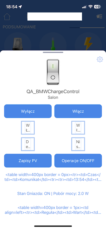

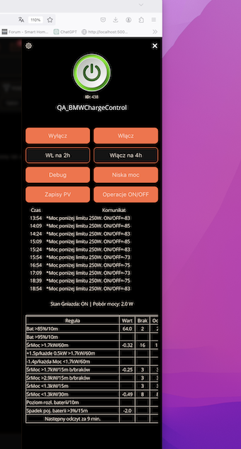

I've done the update to 5.160 from previous stable version (can't recall, I hope 5.150). I'm presenting here three looks of the same interface of QA - two views from computer and from the updated app on iOS. In previous version all three are quite similar (I may said - all was OK).

Just disable in Quick App settings new view in the mobile application.
This change allows natively showing the content of the QuickApps (without loading the webview) inside the app.
QuickApps not using the native interface available in the editor may need to be switched to the "old view".

    Thank you for the advice, it works. But, could you tell me please what do you mean "not using the native interface"? Well - I construct the UI via the built-in creator, only "extra" feature is simple HTML table, but this is a text "printed" in a label area. Is there a better approach instead?
    HTML != Native
    Native view correctly show now in 100% things you can use in the editor.
