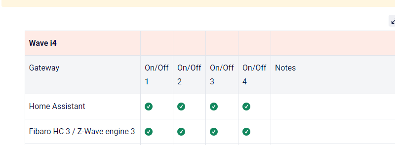

But it is only supported in the z-wave v3 engine and that is still beta and not for production yet :(
so they will be collecting dust untill the v3 engine is more ready.
or will they be supported in the z-wave v2 engine too 🤔 @m.roszak? :D
Link:
