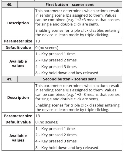

I guess you have to set parameter 40 and 41 to 8 to be able to use it as scene controller :)
Check the device advance settings :)
chrome-extension://efaidnbmnnnibpcajpcglclefindmkaj/https://manuals.fibaro.com/wp-content/uploads/2019/06/FGWDSEU-221-T-EN-v1.2-1.pdf
    Hi Brors94,
    Brillant ! Thanks a lot for your reply ;
    It works fine now ! 🤩
