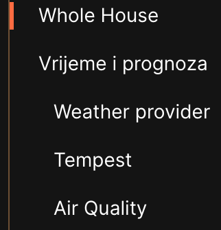

    I cleaned Firefox v132.0.2 cache and I try again. After moving two rooms and going back to Dashboard it does not show new order. I try then with Firefox refresh page and after that was OK.
    I first changed position of two rooms Tempest and Weather provider so that Tempest is first:
    /monthly_2024_11/HC3roomconfig1.png.54dcfd8a0cbf02a192f5103337a89c53.png" />
    and then I return directly back to the Dashboard:

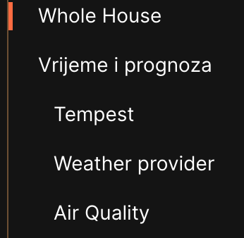

    As you can see on above picture room Weather provider is still first. After using Firefox refresh page
    it is OK:
    Thanks, I will report that.
