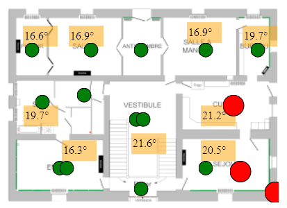

I have just update my HC3 with the latest FIBARO System Update 5.171 Beta for Home Center 3 and now my QA to check if any light is still on in the house have lost all its webview (stair drawing with light position and room temperature)
Now I have in OC web QA view:
/monthly_2024_11/image.png.f87254fc6fce80e0485ed66f06f54b5f.png" /> instead of having this at SVG paceholder: image.png.ec7ec8a0e7fec92828291718456af956.png
The advanced setting, use new view in mobile application is still unticked
Fibaro, Please make a hotfix for that bug or explain me how to recover webviews.
Just to add that web view is no more shown as well in the 2 mobiles applications
