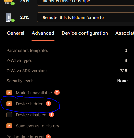

    the remote part that i circled with red might be hidden 🤔
    if you go in the "webview/browser" you can go to settings --> devices --> go to filter and show hidden (upper right corner)--> find the relay device and see if you find the group or parent device your relay and remote are toghter
    This is a "group/parent"  (but from an heatit zm dimmer)
    /monthly_2025_01/image.png.b8520cfee5a910284c61eecd0f1ff635.png" />
    Here you can unhide it:  remember to save after unchecking !!!
