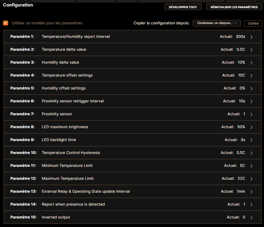

I am experiencing issues with Heatit Z Temp2 Thermostat. It does not engage the linked switch.
Hear are the settings:
/monthly_2025_01/image.png.0a7332da8eda88128d527694fe2a62c1.png" />
Here is the issue:
1. If the climate zone sets a different target on the switch, it does not turn on the switch.
2. If I manually turn on the switch, it does not turn it off in case the target temp is belowthe measured temperature.
Any suggestions?
Thank you a lot

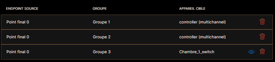

    I do not experience the above described issue, using HeatIt Z-TEMP2 with HeatIt Z-water. Association configuration as below, i.e. no group 2 setting.
    Also just fyi: I am using HC3 running 5.172.23 with Z-wave engine 3 with S2 Security. I do however have above problem, do you experience that?
