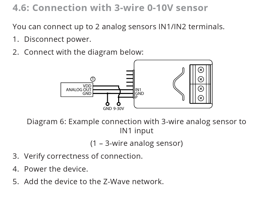

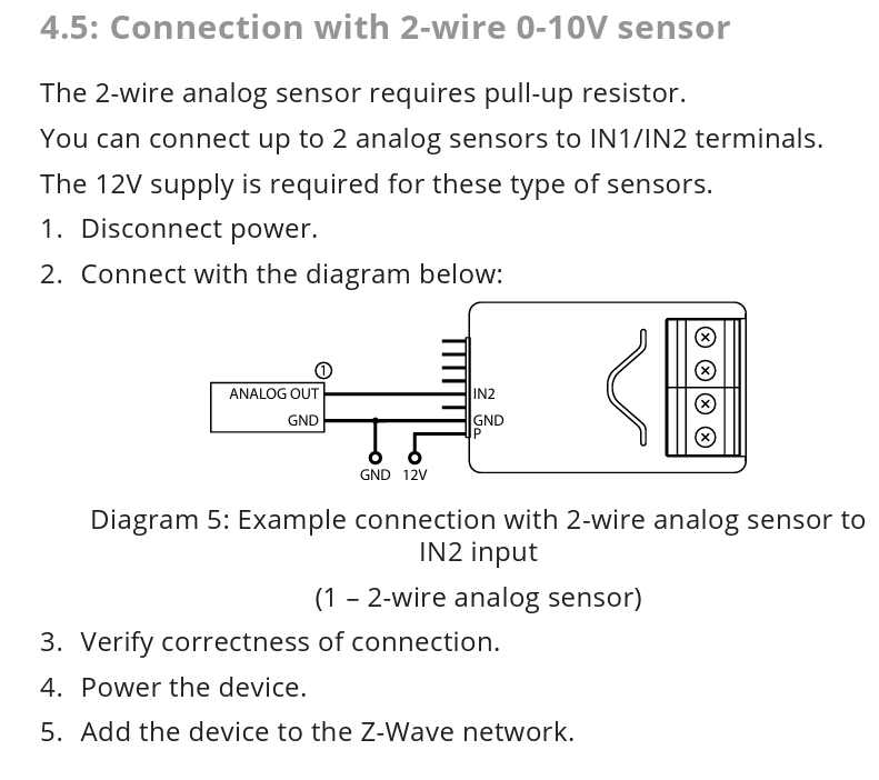

I need to measure presence of voltage 1.8V DC, minimal current (~10-20 mA). I would like to know not even precise measurement, but if the voltage is present or not (other words - if LED is on or not).
Can I use smart implant to do this? Based on the documentation I hope that I can - implant acting as a 0-10V sensors driver.
I don't want to supply power to the "sensor" (as at the wiring in manual), just take voltage read-out.

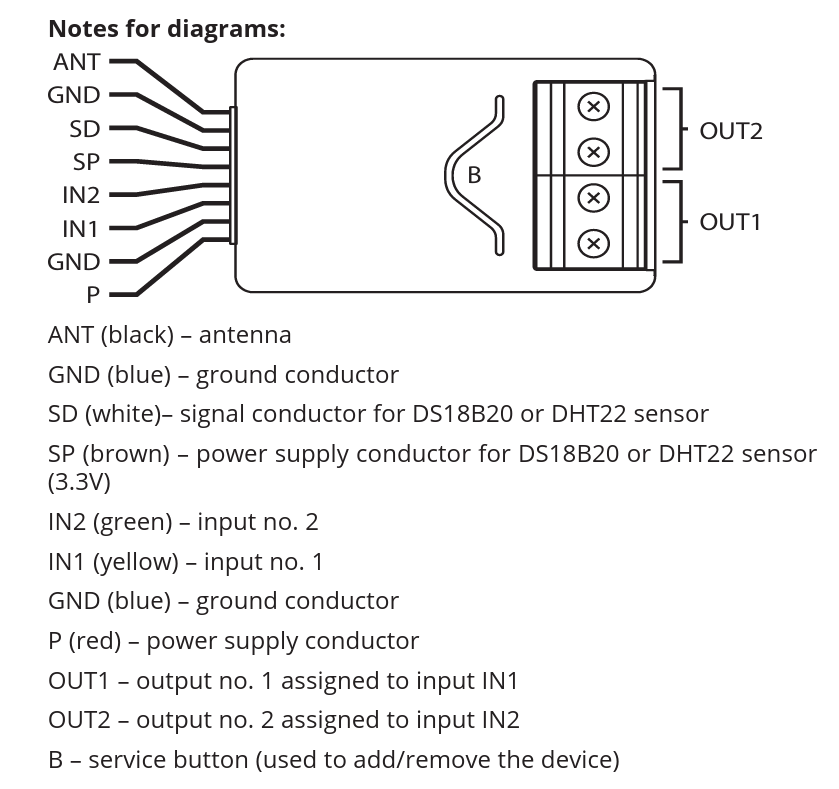

Can anyone with practical experience advise me what can I pay attention? Especially, how to wire it for two independent "sensors".
