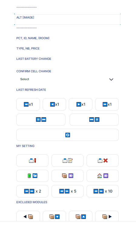

Previously I was getting this view;

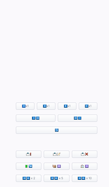

/monthly_2025_02/image.png.8c40fbbd69ce0ee0b3a5fc6a8e618e35.png" /> and now fater having saved my change and making again all buttons visible I am geeting:image.png.b7e66d422d55f4f951c8f1dcc311429b.png
but in edit mode, all labels are still present and correctly defined:
To go back to the previous Labels view, I had to suppress in editor all thes labesl and recreate them all with the same ID and decription.
Note that only after deleting the first Label and recreating it, Fibaro is showing a Warning message that there is a duplicated Label with same ID; Accepting this is making this label to be visible again.
Is there a better way to recover Labels and Select buttons?

On 2/2/2025 at 8:45 PM, Christb said:
Willing to update the code of a QA I developped few months ago, I discovered that all Labels wher not shown any more as well as the select button and all standard buttons had the visible box unticked.
Same happened to me as well.
Go on the QA. You have to simply cancel and recreate the label.
Go on the QA. You have to simply cancel and recreate the label. There no other way...
