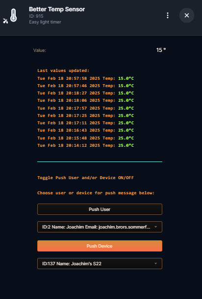

Dont know if will work on hc3L , but here you can try this QA  :)
    @Brors94 Thank you. It works perfectly.
