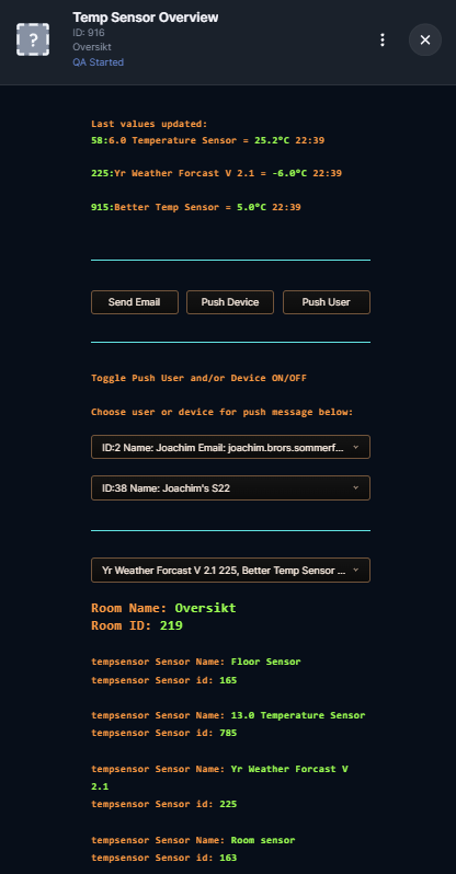

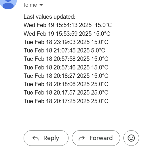

Just want to share a temp sensor QA :)
or
Gives the option to send push or email massage with temp data from QA view :)
Feel free to comment other wishes for more features :D
Might upload to marketplace later :)
Thanks to @jgab for his fibemue, eventlib and tutorials!! :D
Better temp sensor:
Temp Sensor overview:

    Aha,  it isnt actually an interval :D (uses eventlib by jgab to trigger on value reports)
    It updates everytime the device sends an update on the value.
    So if you example got an smart implant with ds18b20 you can adjust the report interval and minimum change before the sensor should send a value.
    and is it the overview or the better temp sensor you are using? :)

    and the autopush function now send push on everyreading so could be to mutch 😅
    It is easy to just make a scene to send the readings every day for example instead :)

    The "send push" button send the list of last 10 temps for now
    But I could add a button in the "hystiresis control" for Auto push when the trigger happen and send last 10 values with a warning 🤔
