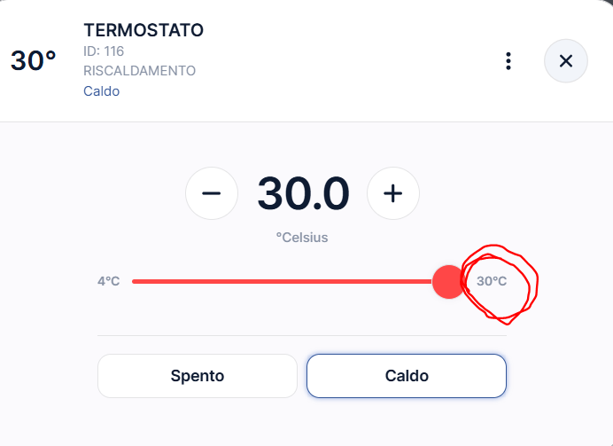

How do I change the maximum temperature range to 60° of the thermostat device? I need to use the thermostat to heat the water variably up to 55°C, thanks to all.
/monthly_2025_03/image.png.2aecf5b411e6096c54b3f08565e5255a.png" />
Create and run a LUA scene with the command
where device_id is the id of your thermostat device
    Not work, i created thermostat device (id117), then i created LUA scene with code on action part, but doesn’t works
    Any console messages when running the scene ?
    heatingThermostatSetpointCapabilitiesMax is for sure the property you have to adjust
    /monthly_2025_03/Schermafbeelding2025-03-07123130.png.a1bf63a903394ef11570eec95b731026.png" />
