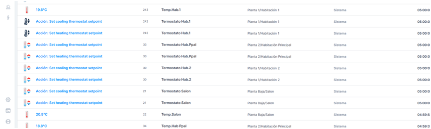

    Is there a message in the system history at 9 PM (like in my system at 7 AM)
    I haven't, I have this when I do it manually at 10 pm but at 9 pm I haven't

    When i check my history i see a something strange
    There are 6 messages per day instead of the expected 4. Extra at hours 0 and 18. Don't know what happens then.
