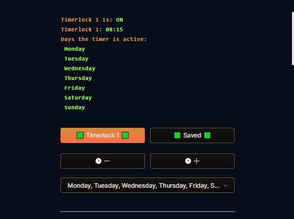

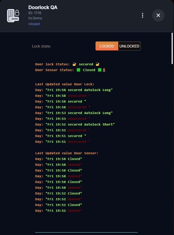

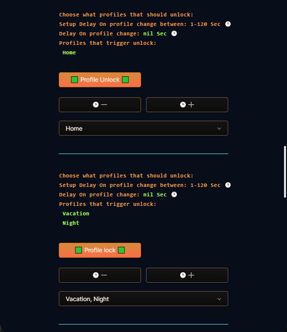

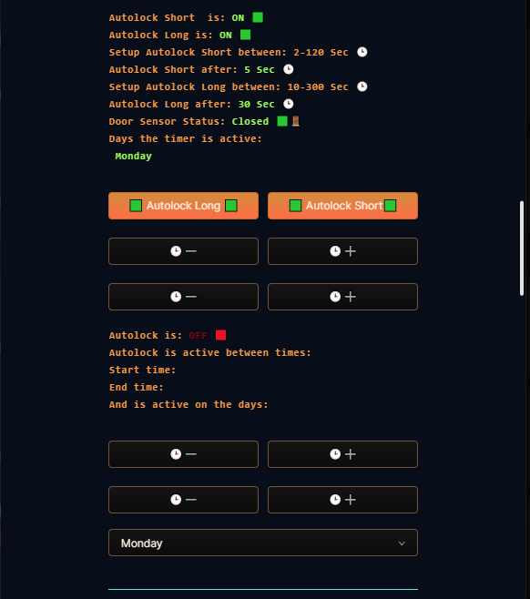

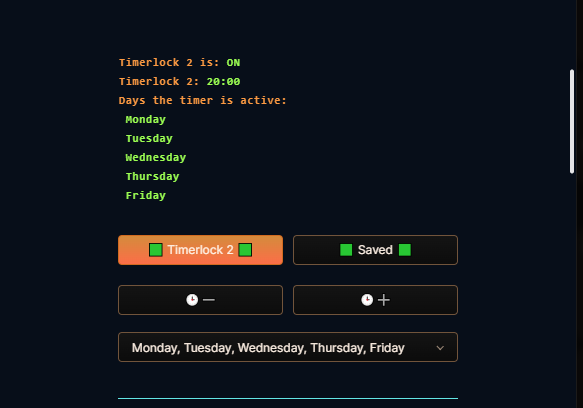

    @Łukasz997
    Want to test my Doorlock Controller? :D
    Would love to have some feedback on aditional functions 😄
    Some pictures
    (have to add time/days setup on autolock)

    I just got finished with the autolock time/day thing :D
    Language isnt supported yet :) Only en. (will add later)
    So now I am going to add the notification senter thing I think 🤔
    Check out new version here:  (found a bug that made the days in autolock not to work 😅)

    After testing it, I wanto to say that it's really complete lock toolkit.
    This which should be changed is minor: the colour scheme for Yubii App (on iphone at last) to make the messages more visible. And small text mistake: when it comes to lock by profile change, description says: unlock. Clever (hidden) hour change in time setting... At start I thought, that I have to click ad mortem defecatam :)
    I really have no idea what can be added more. Super!

    Clever (hidden) hour change in time setting.   I will add a description on the long press to change hours 😅😆
    small text mistake: when it comes to lock by profile change, description says: unlock  and I will check this out to :D
    Thanks for feedback! :)
