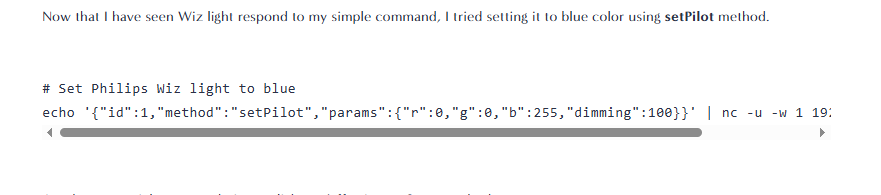

If you go on the link in his post Further reading:
It seems like he got an example of the set dim/colors to :)
