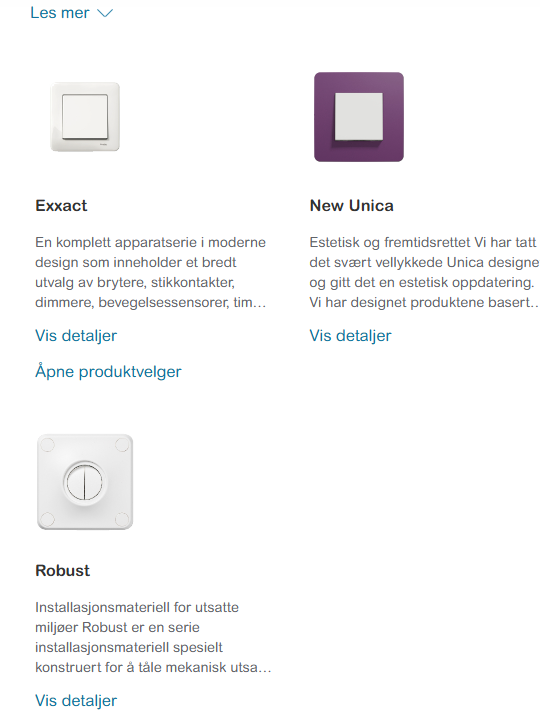

    @Ayno
    I belive you  :D
    But not in Norway 😅
    We use Elko (bought by schnaider a few years ago, Norwegian brand)
    SG Install norewgian brand
    also schnaider, So I know of the brand. Just not that type of switch (Odace 😅
    and alot more.
    But I havent seen that type of switch before :)
    this is the types we get from schnaider in Norway: (we aint a part of EU 😅
