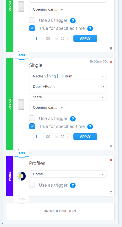

    Hi Cag014,
    Yes, i use alot of sensors that needs to Not been breached within an hour and also that Profile must be "Home".
    Beginning of the scene:
    /monthly_2025_09/image.png.cfe80b03fc6189acdf0825c174d69bc9.png" />
    And at the end:
    And as soon as i trigger it manually, it works as expected..
    I can also see in the History that its not run every 10 minutes..

    Yes, if no movement has been triggered for 1 hour at home, i set the state to away in order to do other things (Like "arming" outdoor cameras so if movement has been detected outside, it will send photos if im away, etc)
    I did however, first adding all sensors to the scene, and after that i added the 10 minutes trigger block, maybe i should re-create the scene and add the 10min trigger first, then add all sensors but i thought it would work anyways?
    It worked great in HC2..
    BR
    Looks like you are correct, once have added sensors it doesn't work...
    Probably a bug... contact service
    Meanwhile create a lua scene with time interval condition and check the sensor by yourself.
