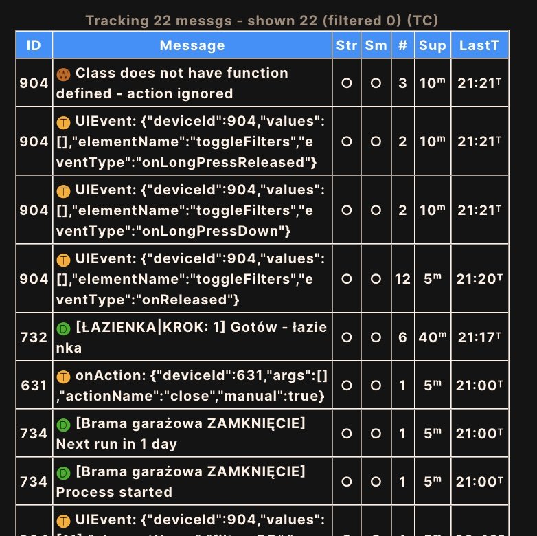

    2. User Interface (UI)
    /monthly_2025_10/mess.jpg.10e2a5b0c956ef8e30b7c349ff6512ca.jpg" />
    Section 1 - Messages from QA itself (e.g. filter compilation errors or warnings). It disappears after a while.

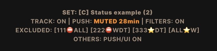

    Buttons have hidden functions when long-pressed. Help is displayed after long-pressing ON & Unmute.
    Section 2 – short QA status. First two lines are self-explanatory. The third line reflects filters and need some knowledge about filters:
    • for ID 111 → all message types are hidden,
    • for 222 → warnings, debug and trace messages are hidden,
    • for 333 → there's complex rule that will be evaluated when message of type debug or trace comes from this source (eval result true = show, false = hide),
    • for all sources -> there's also complex rule but only for warning.
      Everything else is shown (OTHERS: ...).
    Section 3 – list of messages, ordered as follows (simplified explanation):
    1. Storms on top
      • red-hot issues (in storm, not yet informed),
      • then stormed but already informed.
    2. All remaining (non-storm) items.
      Items are sorted by last event time, newest at the top (descending)
    In first column there's message source - ID or name.
    If it's a scene -> color is orange. Devices, QA -> plain color. Named sources as 'ZWAVE' -> blue.
    As table can contain not only errors, at begin of second column is colored small dot with letter (🅓🅣🅦🅔) - it means: DEBUG, ERROR, WARNING, TRACE; Hard to read, but colors are the same as in www console.
    same as TYPES in www console
    All rest columns has the same meaning as in auto:cerr - see description in that thread.
    Please remember that QA always tracks (memorises) all messages - but when you change the filter, some may show up and others may disappear.
