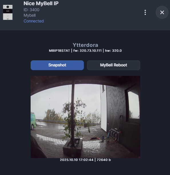

    Is it possible to send a snapshot from a camera on the hc3? 🤔 Since this isnt possible natively on the hc3?
    I guess the 8. real world example is somthing like this? But got to know the Url of the snapshot? and it have to be accessable from the outside of my network? 🤔
    The mybell takes snapshot and shows in QA, could this be sent in a ntfy message?
    Edited by Brors94
    If you have an external url to the pic you could include that in the message? (could you send it to some external storage with link?)
    If your pics are only available from within your network I have no idea at the moment...
