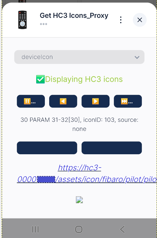

I have created a QA able to display all Icons stored in my HC3: it is working perfectly when unsing the PC web view as shown below:
/monthly_2025_10/image.png.40030fac4e69f2a9a283ac359ca592c8.png" />
but when I am using the mobile application, the QA does not show the image as shown below:
I have checked that the parameter " Use the new views in mobile application" is unticked
I think that with with previous version (<5.181.62) it was working...
I am using the followind command to show the image in "Label0"
local im1 = "<img src='http://hc3-0000xxxx/"..path1.."'>"
          self:updateView("Label0","text",im1)
where 'path1' is giving the location of the selected icon in my HC3.
Is there another way to have the image displayed or is it a bug in new mobile Yubii version?

The PC web UI works because the icon url is resolvable inside your local network. Your PC and HC3 is on the same network.
For the app I assume that it access the HC3 using Fibaro's external proxy, allowing it access to the HC3 inside your local network (and firewall).
The url you have is not resolvable from outside your network..
    Yes, so I have tried forcing Yubii to have a local access and images are then displayed.
    Some are still not displayed but I need to check if their path are correct.
    I found very complex to get a full list of the Icon used by Fibaro. also all new icons are now svg type, drown when HC3 needs to display it 🙁
