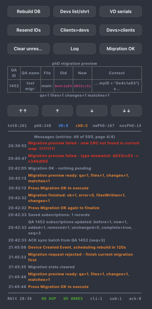

    I would like to share some progress on the DNS development.
    I’ve honestly never hit this many implementation problems while trying to make a system fully watertight. It seems to be a general problem for any solution where components cooperate asynchronously. In Fibaro this is even more visible, because there’s basically no built-in support for this kind of communication: fibaro.call(...) is like “fire and forget”. The entire handshaking and reliability layer has to be done manually.
    At the moment both the DNSfD server and the client-side toolbox are stable, although not entirely free of small gaps that come simply from the nature of the problem. Using DNSfD requires an understanding of how it works, even though the user is supported as much as possible and the usage is simple. If one doesn't know how the mechanics work, can cause themselves (reversible) trouble. For that reason it probably won’t have many users, even though it can be absolutely invaluable “once a year”.

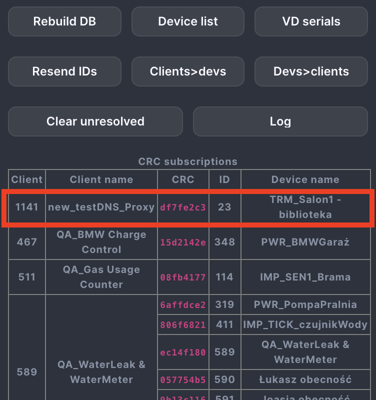

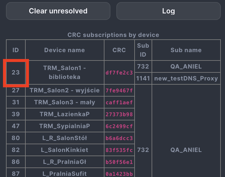

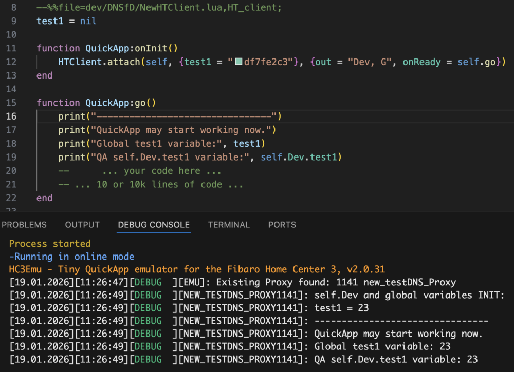

    Example usage:

    Maybe previous example of usage is too complex. Simpler form of subscription for small QA, using only one ID reference.
    Above lines + ~300 lines universal toolbox aside is the complete cost of participance in DNS. If you use only SSN subscription, toolbox can be half smaller.
    Not much, I think...
