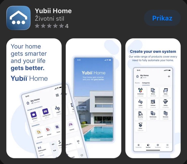

    36 minutes ago, Sankotronic said:
    As soon as a message is received on your mobile telephone, if you tap it to see complete message
    You can open and read the message by tapping the down‑arrow on the notification. It works almost the same way as on an iPhone.
    What I said that Yubii Home application doesn't receive push notification at all while Yubii Home Center app works fine. So the issue is in Yubii Home android app.
    52 minutes ago, Sankotronic said:
    Fibaro added Notifications option in Yubii app does not have anything to do with the push messages send by user code from either scenes or quick apps. Actually I do not see any benefit of having this since they never explained how can be used.
    Well. I use the notifications to tell the user of my quickapp there is a new version.
    22 minutes ago, cag014 said:
    Region    Android                 iPhone (iOS)    Worldwide    70–75% 24–30%   United States    40–42% 58–59%   Active Devices    3+ billion 1+ billion
    Hi @cag014,
    I wrote "in my opinion Android is crap", which means that I think is crap, not entire world, so let us stay at this point. I could mention that I have some friends that use Android phones, but they complain that Android software is a crap 💩, not phones, since some of the hardware is really excellent, just unfortunately running that Android crap ;-)
    To be honest it is not much different with iPhones and their software is becoming more and more crappy :-D
    Still when I compare software Android and iOS, iOS seems still a bit better and more safe than Android. If you don't believe me you can search how iOS handle payments and how Adroid does the same thing.

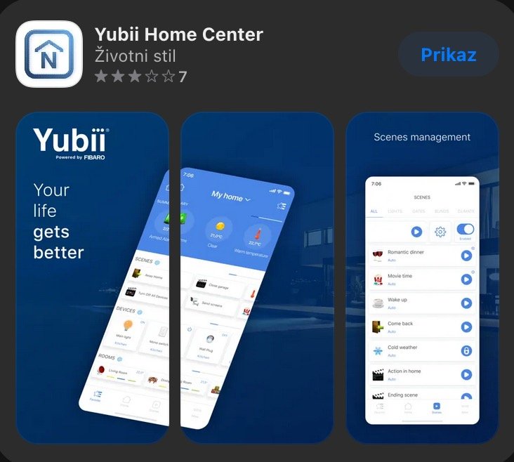

    Regarding mobile apps, I use Yubii Home:
    and what I wrote about push messages on iPhone is valid for this app.
    I do not use Yubii Home Center:
    since what I understood this app was made with backward compatibility with HC2 and for me it never worked neither with my HC2 (always dropping out) neither with HC3 due to some different approach to show quick apps (actually not show master quick app of some types).
    I hope that @m.roszak can maybe once and for all explain difference between this two apps and which one is recommended to use with HC3 and Yubii gateways?
    That is interesting. I know there is mention of this type of notifications in old and outdated developer "manual" that was not very useful to me. If you can find little time to give your code example how to send this type of notifications? It is very possible that I didn't properly understand that "manual" and was doing something wrong.
    Thank you!
    Yubii Home Center is compatible with HC2/HCL hubs, in maintanace mode mostly.
    Yubii Home (the new one) is compatible with all new hubs - HC3, HC3L, Yubii Home and Yubii Home Pro, this one is for sure the best one to use with the new hubs as all the new featurs comes to this one.
