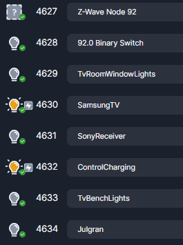

    Here is the Manufacturer Name, Model and version:
    /monthly_2026_05/image.png.66d5944c965fd97fe583df41ece7a07a.png" />
    These are the device IDs:
    I just did a reconfiguration.
    I have sent you the logs in a private message (Please let me know if you wanted other logs)
    BR
