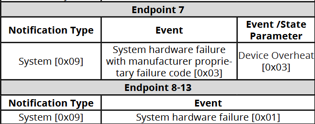

If it's node 7, then the device is overheating.
If it's from node 8+, you seem to have some issue with the connected DS18B20; it's best to check the connection.
If those reports (in general) temerature, then the error is reccuring (on 2wire bus) but it does not affect the funcitonality.
In this case you can disable this notification in "Notifications" to get rid of those.
(ZW2.0 did not support all notification in full generic way as 3.0 does)

    No, from time to time there is an error on 2wire bus which does not affect the operation - open the main root endpoint (settings of the implant), go into notifications tab and disable the hardware failure fault reporting :)
