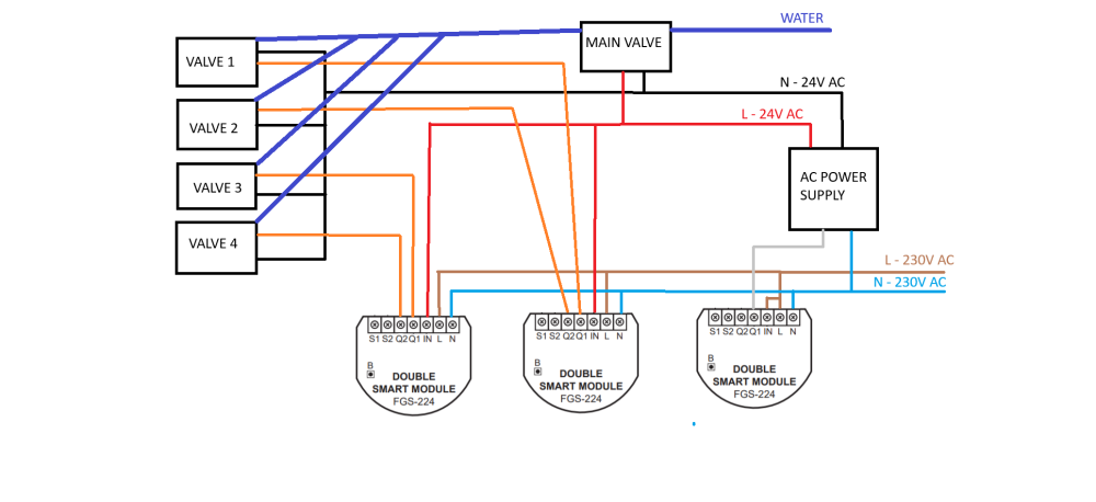

  1. Hi everyone, I’m looking for some help configuring my irrigation system in Fibaro. Currently, I manage 4 zones using a custom QuickApp, but my current "schedule" is a bit of a hassle - it's a semi-manual process that requires manual triggering. I would like to fully automate this while still retaining the ability for manual control. I need to implement a specific logic for each zone (Section 1–4): Startup Sequence: The power supply and Master Valve must activate first, followed by the specific zone valve after a 1-second delay. Interlock: The system must prevent two or more zones from running at the same time. Manual Lockout: Manual control of the valves should be disabled while the automated schedule is running. Crucially, I want to manage the schedules via Fibaro’s built-in Sprinklers Panel. My goal is to ensure that the safety interlocks and startup logic (Master Valve delay) are fully integrated with the native system scheduler. My current QuickApp works fine, but it lacks the smart automation and logic mentioned above. I’ve attached a wiring diagram for reference. I'm open to removing the QuickApp if it's necessary for the new setup. Thanks in advance for your help!
