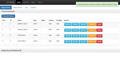

Guys , i just updated HABRIDGE to 4.1.2 for google home integration , but i think that was a mistake , now i can't make alexa work again .
I don't know how to add the devices in this new interface of HABRIDGE :( .
I'm at the beginner level in this things so you know :D .
Alexa discover the devices. ( Habridge is working )
Any help?:(
Thank you.

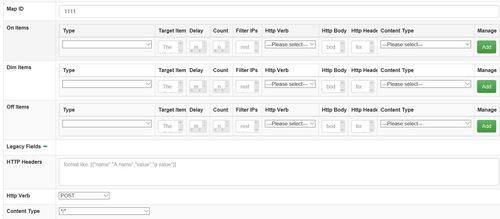

It looks like the format on HA Bridge has been completely changed (v4.1.2) and I have no idea now how to call for Fibaro Scenes? Anyone?
@tcviper. Give this a try
Type should be "HTTP Device", the "Target Item" should be your http URL call and the body should be blank as that is used for POST and PUT methods
For Fibaro i will complete just the :Type and the Target Item.

He guys,
I have the Ha-Bridge new version (4.10) working with Alexa Echo DOT and Fibaro HC2 4.10
Device type: Custom
Map Type: Domoticz Device
Type: Domotics Device
On items: Target: http://<name%40e-mail_domain_name>:<fibro_password>@<IP>/api/callAction?deviceID=<number>&name=turnOn
http: get
Content type: */*
Type Domotics Device:
Dim items: http://<name%40e-mail_domain_name>:<fibro_password>@<IP>/api/callAction?deviceID=<number>&name=setValue&arg1=${intensity.percent}
http: get
Content type: */*
Off items: http://<name%40e-mail_domain_name>:<fibro_password>@<IP>/api/callAction?deviceID=<number>&name=turnOff
http: get
Content type: */*
I asked on Github, here is the answer .
Is working with Alexa and Google Home . ( Tested )
Http Device and Target is the URL Command.
Cheers.

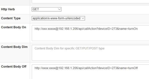

any solution for send the right commando to the fibaro HC2?
this works for me:
http://user:[email protected]/api/callAction?deviceID=199&name=turnOn
Don't use a mail address for username, create a new one and give him necessary rights.
In habridge set "Http verb" to GET and "Content Type" to text/html.
