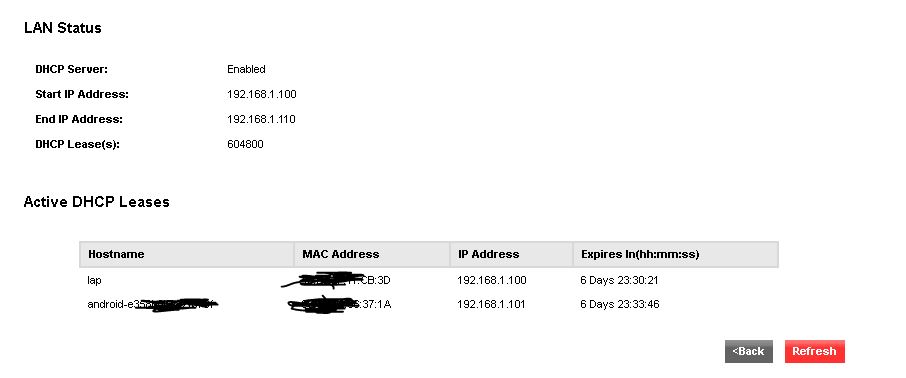

    Specially for FIbaro team screenshot.
    Where is FIBARO HOme CEnter ?
    All DHCP devices could renew new ip adress after router restart but not F. :(

    Solution on DHCP is to Bundle Ip adress on router. (for FIbaro,Ip Camera and other devices steering by plugins with Ip).
    I set my devices on dhcp server to static ip.(devices also must set for static ip)
    Instruction for settings router.
    The IP address must be different from the IP address set on the LAN Host Settings area, but they must be on the same network segment.
    You can set the IP from webpage manager of Huawei B593,
    1. Choose LAN > DHCP Settings.
    2. Set the DHCP server to Enable.
    3. Set Start IP address.
    4. Set End IP address.
    5. Set Lease time.
    6. Click Submit.
    Bundled Address List
    2. Click Edit List.
    3. Click Add.
    4. Set the MAC address and IP Address.
    5. Click Submit.
