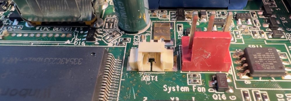

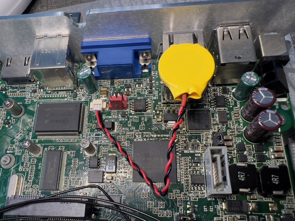

Same symptoms/problem here and it was the CMOS battery. I purchase a new one with the lead and plug already attached from eBay type is a CR2032 BC13 for £2.60 (photos attached) Straightfo
