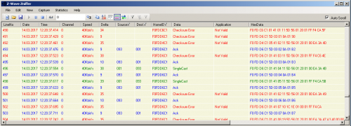

    it is not latency due to RF but due to how the protocol ensures that the data has been send and received (ACK frames on pictures page 2) by target device, and if not the (by the protocol defined) re-transmission will be executed and finally (if re-transmission not worked 3 times) different route will be taken. Of course one could just send "on" and hope that a lamp will go on, but this is not how zwave works (luckily).
