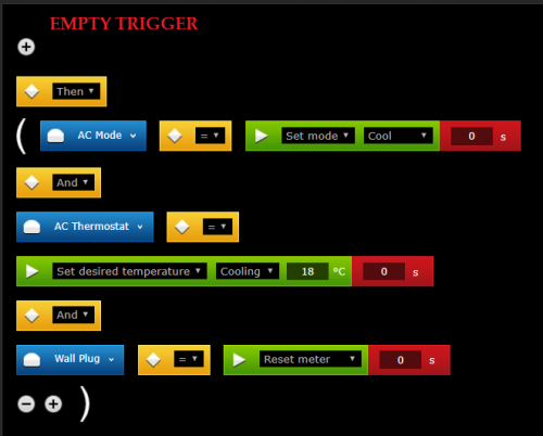

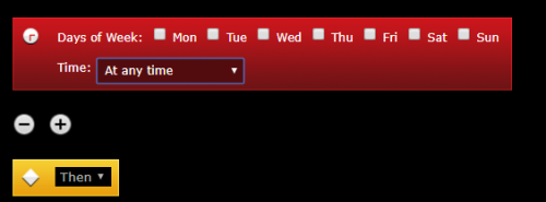

    Posted
    I can see only some of my Block and LUA scenes.
    I have created a new one using blocks and it doesn't appear in the Alexa devices list (I have used Discover Devices function)
    Do you all see all of your scenes? (I know that Magic Scenes are not yet support)
    • 0

    Posted
    Hi!
    I haven't located the Customs Skills yet.
    Some of the scenes simply shows on the devices list. Nothing special done. Just pressed the Discover Devices.
    It appears on my Alexa App as "Scene connected by Fibaro"
    I can activate the scene by saying "Alexa Activate name scene"
    • 0

    Posted
    Sure!
    Here is the attached print-screen from the web Alexa app. It's the same as on mobile version.
    As previously said, only some scenes are visible in the Alexa devices so I have copied a scene that was visible and changed to do something else and it worked.
    Bellow is the LUA code from the that block scene that worked.
    %% properties
    %% weather
    %% events
    %% globals
    DSC_Zone001
    DSC_P1_ArmedStatus
    DSC_Zone004
    local startSource = fibaro:getSourceTrigger();
    if (
     ( tonumber(fibaro:getGlobalValue("DSC_Zone001")) == tonumber("0")  and  tonumber(fibaro:getGlobalValue("DSC_P1_ArmedStatus")) == tonumber("0")  or  tonumber(fibaro:getGlobalValue("DSC_Zone004")) == tonumber("0")  and  tonumber(fibaro:getGlobalValue("DSC_P1_ArmedStatus")) == tonumber("0") )
    or
    startSource["type"] == "other"
    then
        fibaro:call(173, "turnOff");
        fibaro:call(349, "turnOff");
        setTimeout(function()
            fibaro:call(511, "pressButton", "3");
        end, 2000)
    end
    If I create a new scene from scratch ... it's not showing in the Alexa Devices neither after manual Device Discovery.
    Controlling devices seams to work pretty ok but starting scenes it's a bit tricky as you have to say a long phrase for commands and most of the times Alexa fails to understand the command or start the correct scene. It may also be that my english pronunciation is not quite "americanish sounding"
