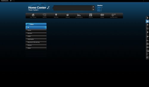

I dont know if anyone else has come accross this, but this morning my system seemed to have froze! My last scene that ran was about 00:05, and after that i have just a couple of scenes to turn off bedroom lamps and these didnt work, neither did the morning water heating, central heating scenes etc
when i tried to manually run them nothing worked. tried to disarm sensors but they would auto-re arm. tried the dimmers and they would stay on. no scene would run.

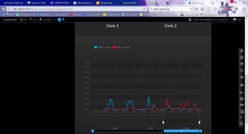

    @AutoFrank has given me a VD, which i am currently using and am monitoring the core cpu usage.
    when i get a chance will amend the code and get it to plot a graph on thingspeak and make public so everyone can see. hopefully should be able to work out firstly when it actually crashed and secondly will have a look at scenes to see what was active at that time.
    thanks again for your thought

    2. web cannot login see pic in first post - i even clear cache etc Didnt try phone app, will try next time

    On another note i have added the Thingspeak graphs so link here to monitor the Core 1 & Core 2 memory usage:
    Also there was a discussion on 'Polling' so i have gone through all my devices and disabled polling on all devices that i didnt need. so lets see what happens.
    cheers

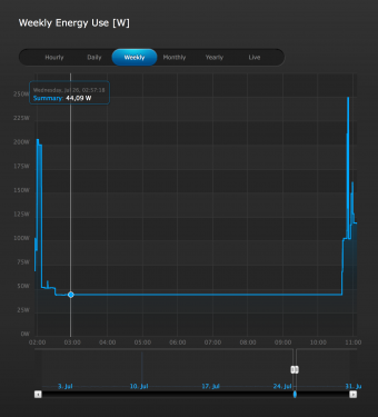

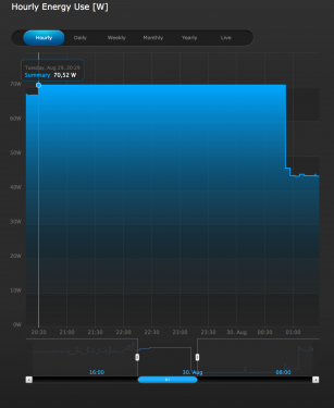

    Here is the power report from when the HC2 crashed, got stuck, maybe this brings more info.
    Even though the z-wave light was flickering nothing was being recorded from devices.
