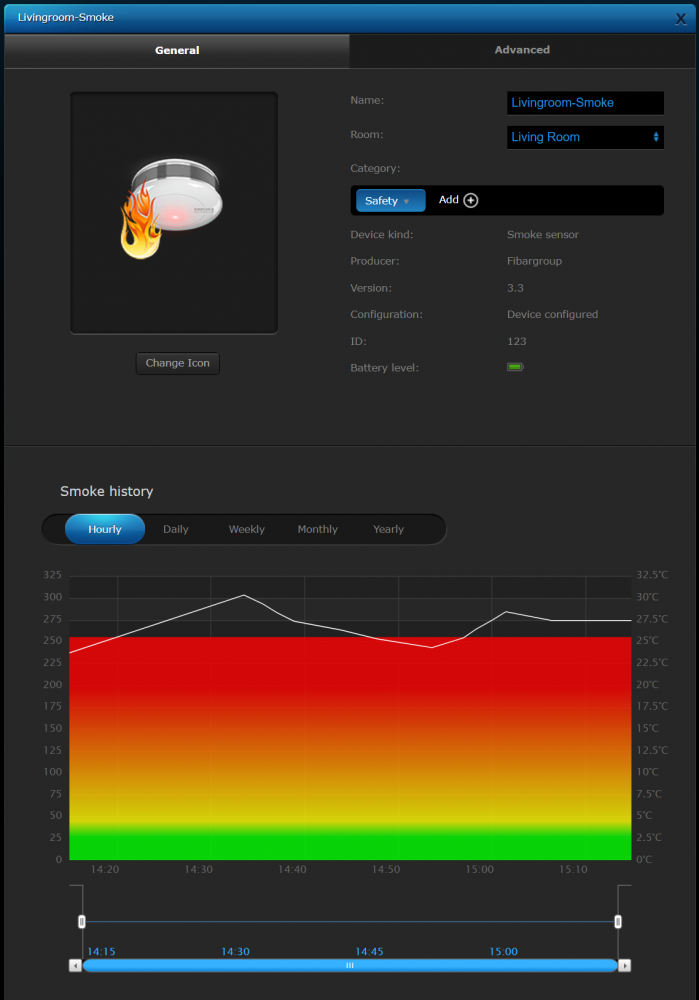

In the middle of the night suddenly my Fibaro smokesensor v3.3 gave a firealarm (I see  also that the smoke alarm is breached in the HC2 for that sensor). So I went upstairs, but there was no smoke (also no smoke in the history of the sensor in the HC2). I removed the battery to sleep again. I have two questions:
- Why did the smoke alarm went off? There was no history of smoke in the sensor in HC2 (the graph was like the whole day). Any idea how I can troubleshoot this?
- Why did the other smoke sensor (gladly for now) didn't went off?
This is the first time it happend and I have 12 Fibaro smoke sensors.... BTW I don't get any notification of a firealarm in the HC2 itself (glady I had a own virtual device) of other mobile devices from the standard interface of the HC2

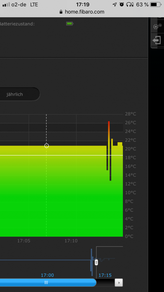

    I can get the graph also from my Z-Way controller, was thinking about the graph from the sensor inside. In HC you get an % value that shows the actual dust value.
    I checked this with a friend and we can see 2% to 4% on different times/days. He also had false alarms, but this value was never high.
    So i thougt of getting this value for different controllers, as i assume the sensor is sending this value. But where and when????

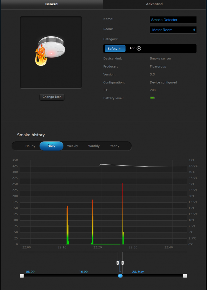

    • Alarm going off without smoke, the history shows zero smoke density 0.0. Today this happened a few minutes after replacing the battery.
      The only way to stop the alarm when that happens is taking out the battery. After re-inserting of the battery, the fire status of the module in the HC2 dashboard only disappeared after soft reconfiguration. (Logically, the module will never send a status change after false alarm as the smoke level is already zero).
