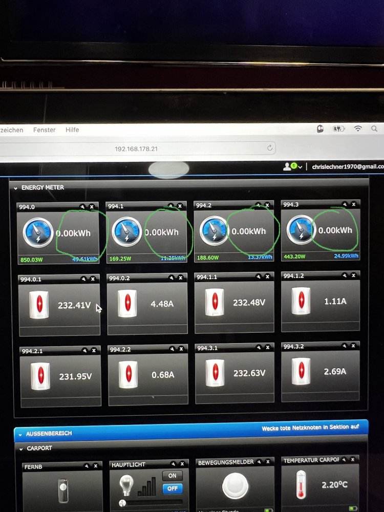

I have now found the solution to this problem. The HEM device needs to be updated with a new firmware version to work with the HC2 controller. After upgrading my unit to firmware 1.03 it works fine an
OlegV
From their support: These are the firmware updates for V1.04 which is the latest version. (V1.03 removes parameter 2, while parameter 2 was re-added on V1.04). So, probably doesn't matter.

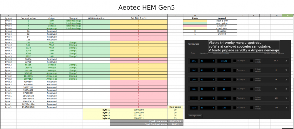

Resolved :). All three terminals measure the consumption in "W" and also the total consumption separately. Specifically, Volts and Amperes are not measured in this calculation. e43aa85c5909f320b
