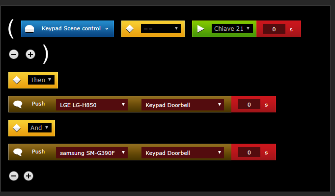

    Is anybody has a scene to control his Keypad popp ? Please.  Thanks
    it's not difficult..
    if a user entry the second code  (chiave 2):
    /monthly_2018_09/57095138_2018-09-1709-41-09.png.ad508886bba92bc4c3c5121bc010969e.png" />
    if a user push the keypad doorbell:
    If a user make an error in the entry code:
    If a (user ?) try to open the keypad (tampering):
    Codes 1-20:   user codes.
    Code 21:         keypad Doorbell.
    Code 22:         keypad doorbell pressed twice.
    Code 23:         error entry.
    it'all.
