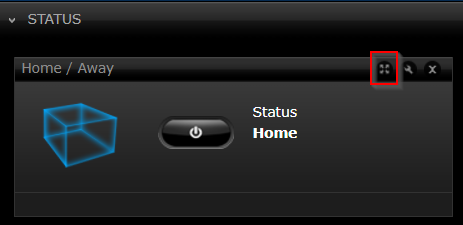

When I look at My house the virtual device looks like this:
And I have to click the "open?" symbol to click the Home/Away buttons. Is it possible to get those buttons at the "Main" screen?
