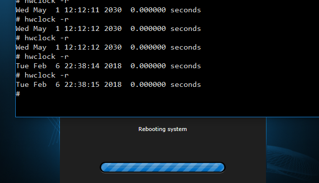

4 hours ago, nickarsow said:
or there is a big mess in the firmware.
Here we go, RTC and timesync results HCL fw 4.160:
I did checked if the RTC is being used at all when changing date/time via location (v4.160 HCL), so i did stopped RTC (by shorting crystal pins)
/monthly_2018_02/crt1.PNG.bd7fdc721f70661f751bd4248f02df54.PNG" alt="crt1.PNG.bd7fdc721f70661f751bd4248f02df54.PNG" />
and got time difference (ignore the local / CET hour diff)
After time change (manual) and reboot both RTC and Linux time are synced (ignore the local / CET hour diff)
Same result has been archived with NTP (again, stopped RTC, changed time to use NTP, after reboot both are synced).
I did removed the backup battery, time got reset to 1970 after reboot:
In location i did changed to manual (from NTP) - without saving, and changed back to NTP - saved, and time is again ok, watch changes while reboot:
After power off for few minutes and power up, HCL still shows proper time:
That means, RTC and time sync are properly implemented in v4.160 firmware, it must be hardware issue on your HCL.
