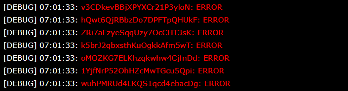

    Hi Dave,
    Thank you.
    I using your code
    /monthly_2018_10/1_fibaro.png.60655046b7d195890bebf4af49301fc3.png" alt="1_fibaro.png.60655046b7d195890bebf4af49301fc3.png" />2_Fibaro.png.f1c1fe527381302a7b5708b601b2b729.png
    But since 1 month a get no result in AllTings...
    In my HC2 debug box are a lot of errors... see attachments.
    I hope you find the error.
    Thank you in advance.
    Volker
    Sorry, the code has been deleted:
    can you patch  "success" method
    IMHO you have issues on allthingstalk site side!
    btw,  you can run this LUA scene without "header" triggering. for example once an hour.
    That is the new error report...
    Thank you.
    403?
    omg... Error 403: "The server understood the request, but is refusing to fulfill it. Authorization will not help and the request SHOULD NOT be repeated."
    so, are you sure what
    1) you provide   right  cred in LUA script according to site
    2) you do not change the password on site last month? (and not update LUA script)
    stop. maybe
    change API endpoint. idk
    as I can understand (after quick reading) your site change auth. now you must log in two steps: first get auth key-token, second make to call to update your data. here you should provide [{"key":"Authorization","value":"Bearer {{token}}"
    good luck in development!
    Sorry, I am to stupid for that, I found no solution... Have anyone solved this problem?
    Thank you
    Volker
    Hi @Volker
    The authentication method for AllThingsTalk has changed and no longer uses the ClientId and ClientKey authentication method.  This has been replaced by a device token.  Please take a look at the original post where I've posted the revised solution:
    Dave
